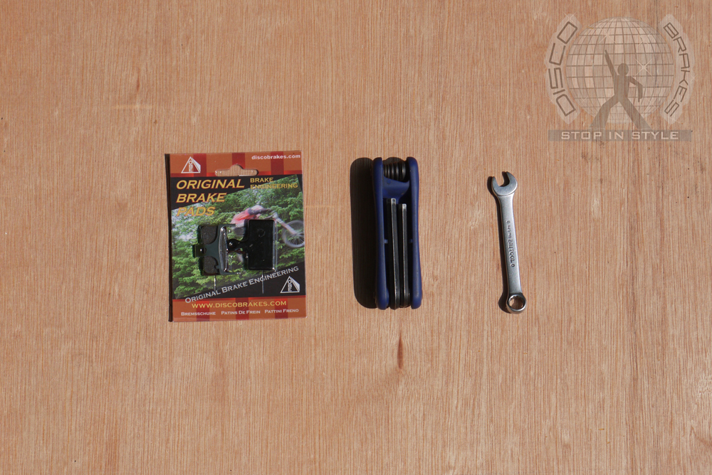

What you need before you get started:
1.) A pair of correct model disc brake pads
2.) An allen key / multi tool
3.) A small spanner (or similar) to push your pistons back in

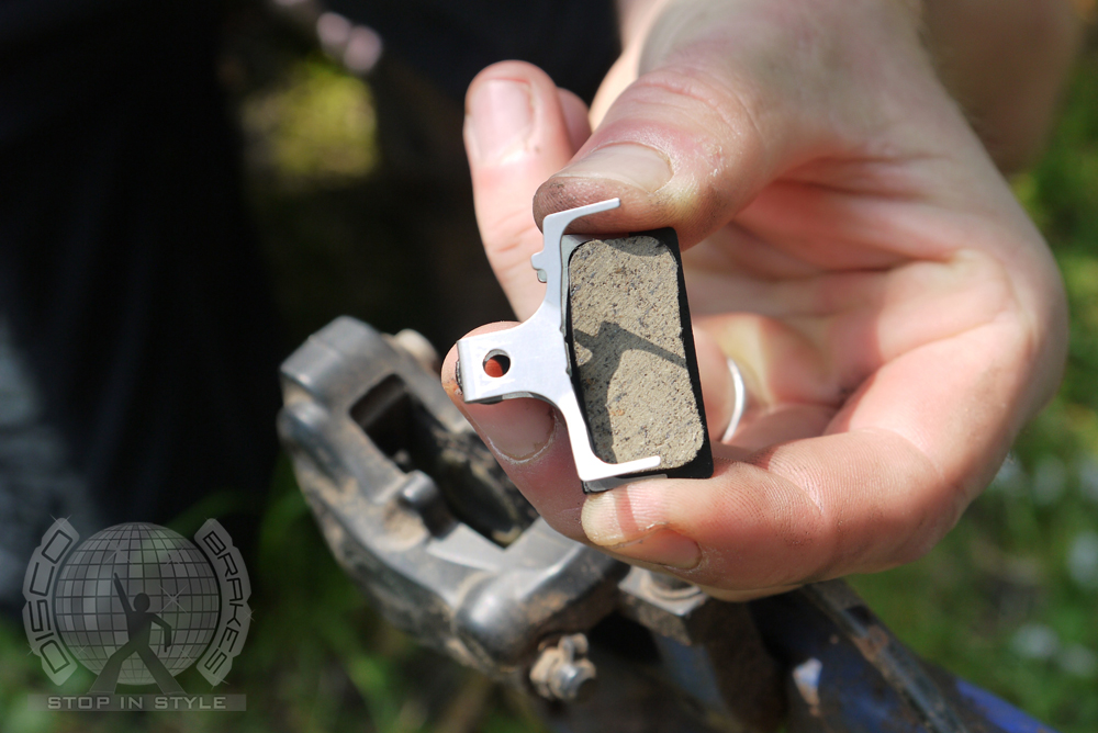

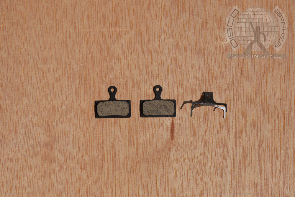

Remove the pads and spring from the packaging.
The spring will go between the pads.
Do not touch the braking surface of the new brake pads or the braking surface of the disc rotor at any time.
Natural oils on your fingers are enough to contaminate the new pads and/or rotor rendering them less efficient or noisy under braking.

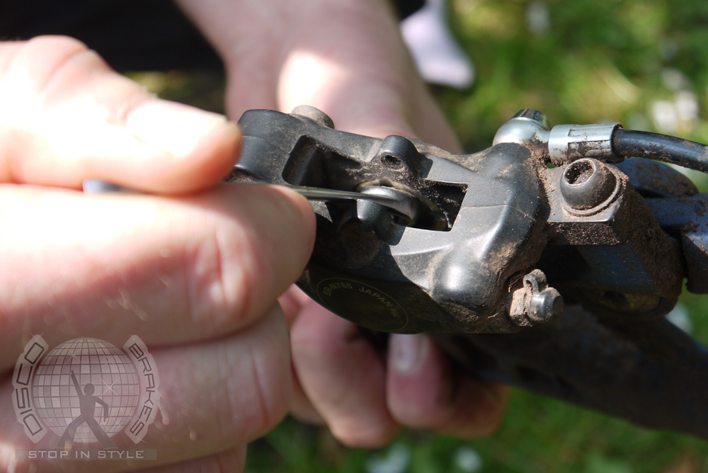

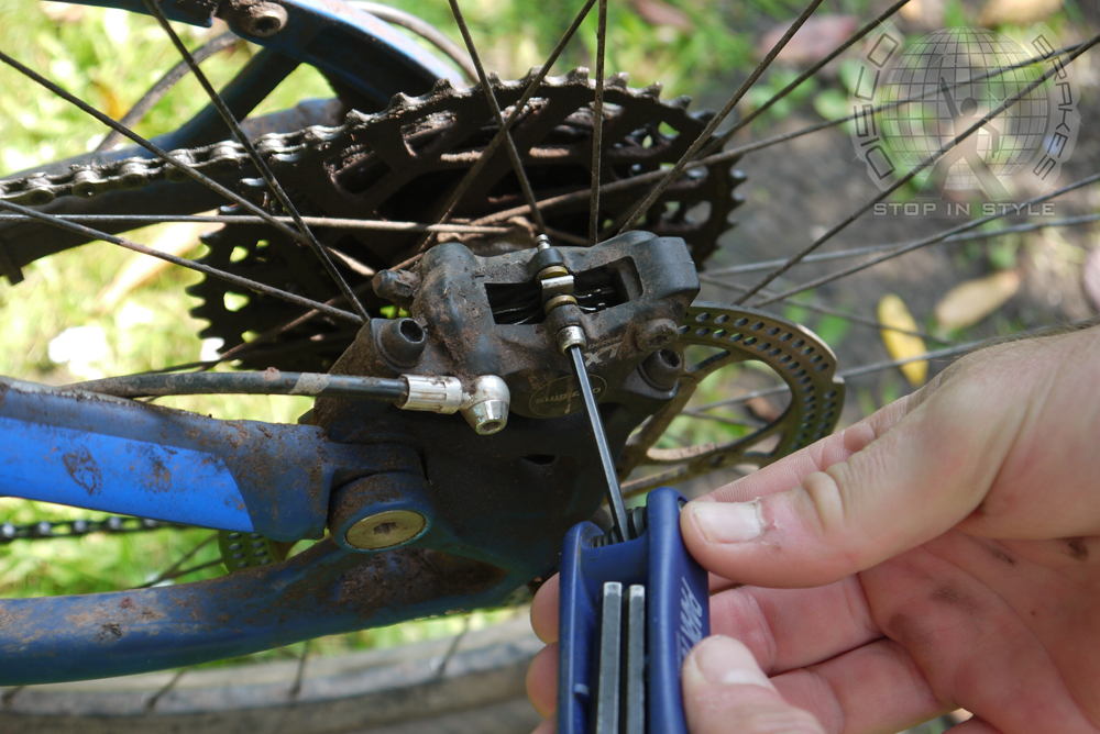

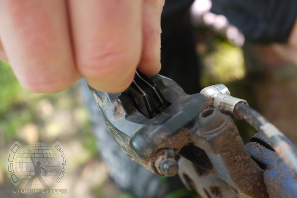

Use the allen key to remove the safety screw which prevents the pads from falling out. Some brake models use a pin here.

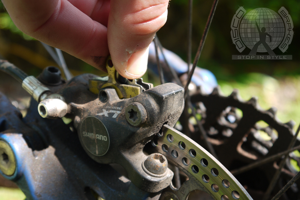

Remove the pads from the brake calliper
Important Note: Do not pull the brake lever with the pads removed from the calliper

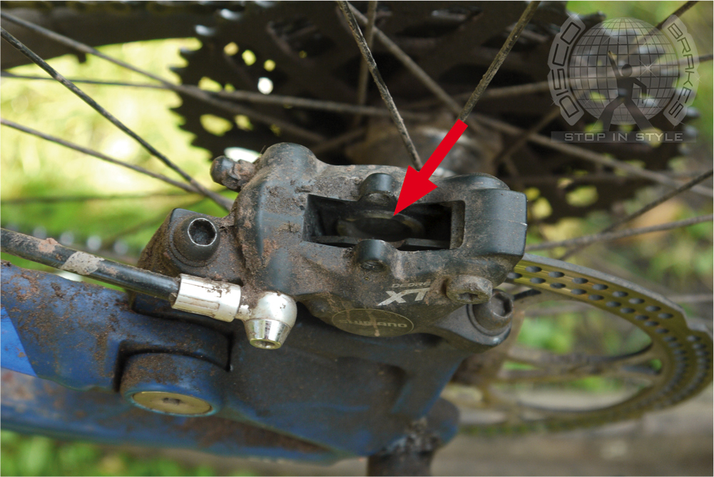

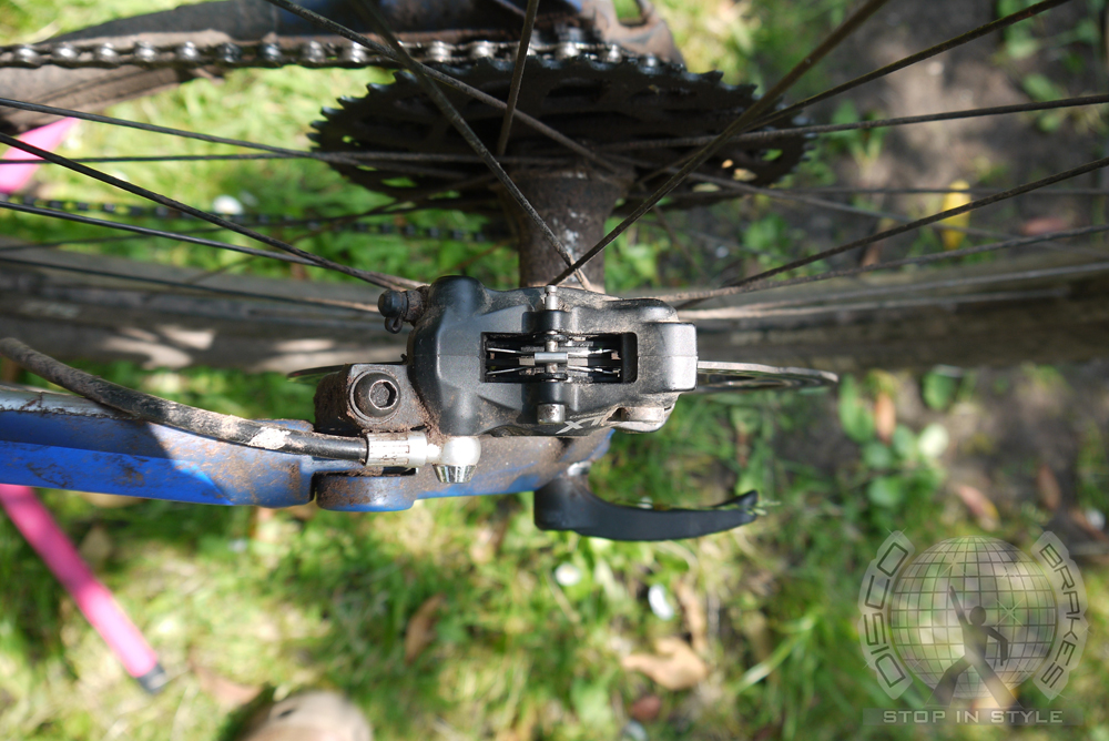

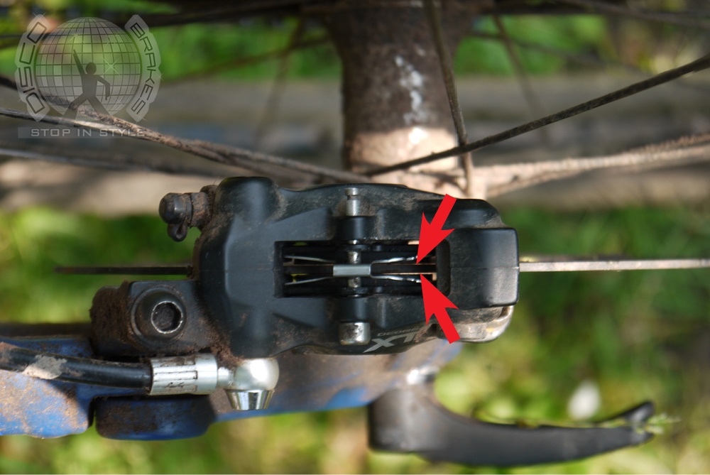

View of the brake calliper after pads have been removed. The pistons (white round cylinder inside the calliper are visible – red arrow).

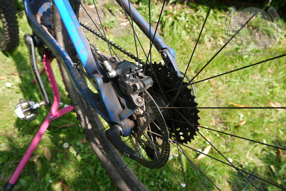

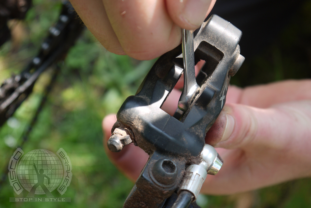

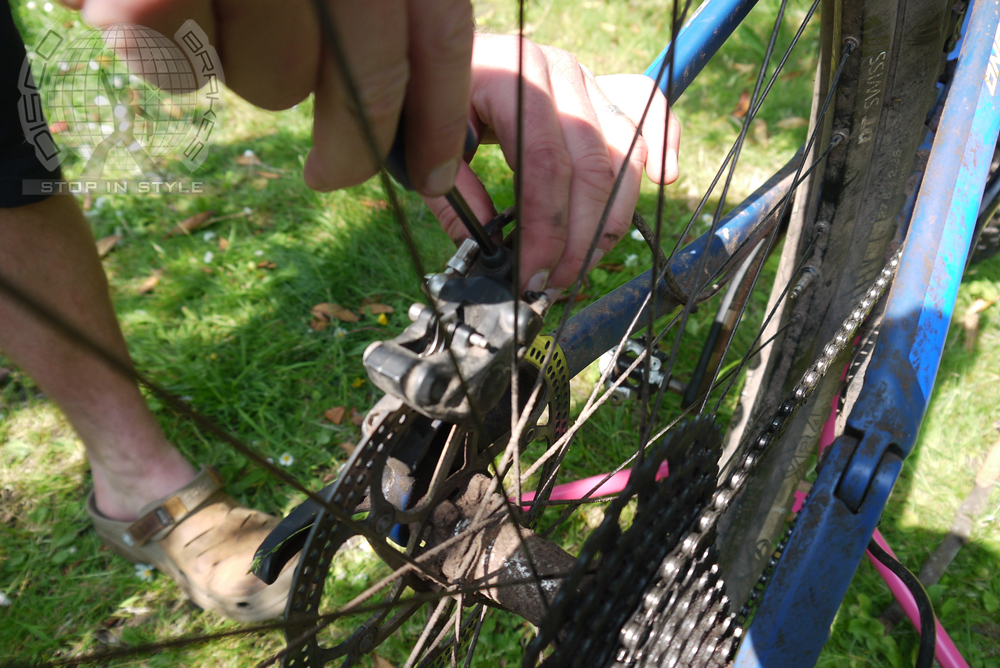

Remove rear wheel so that you can work on the calliper. Use the small spanner to push the piston back into the calliper to be able to fit new (and therefore thicker) pads.
Please do this on both sides.

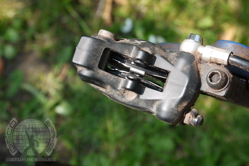

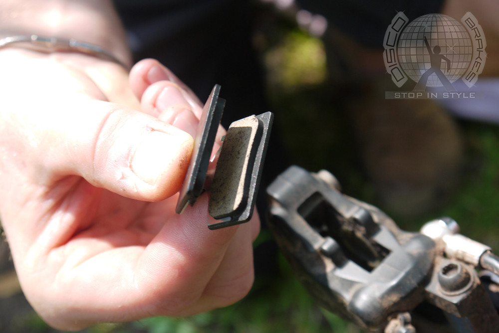

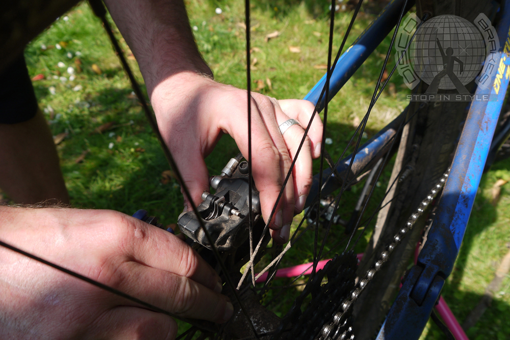

Put the new brake pads together with the spring inbetween.
Fit the brake pads back into the calliper and push them down so that the eyes for the safety bolt/pin and eyes on the pads line up.

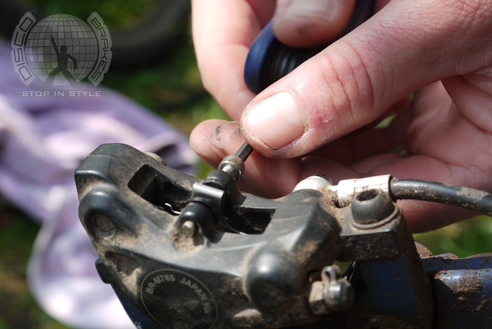

Fit the safety bolt/pin back in place.

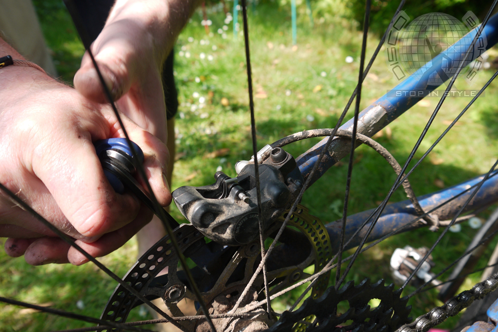

Unscrew the two bolts that attach the calliper to the frame.
Align the calliper so that the disc runs through it without touching the pads and tighten the two bolts once calliper in the right place.

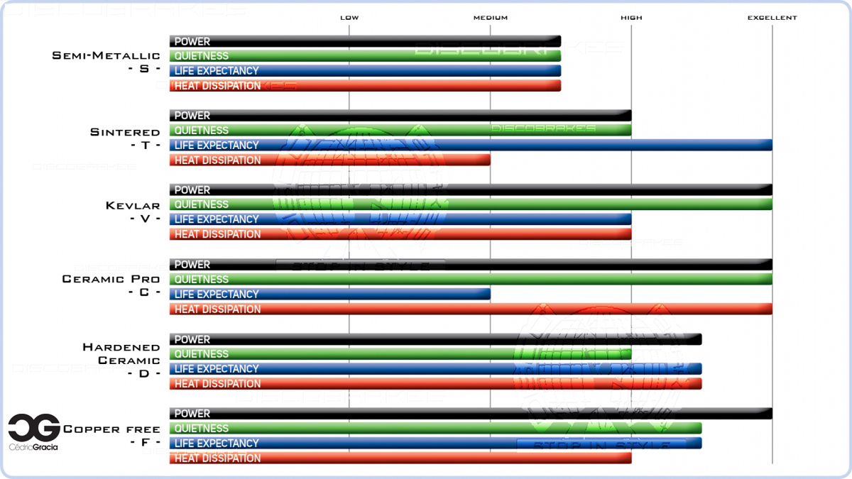

PostPosted: Tue Nov 01, 2016 3:41 pm    Post subject: DiscoBrakes compounds chart Reply with quote
Here an easy breakdown of the characteristics of our various compounds so that you can find the right one for your riding style and requirements.
