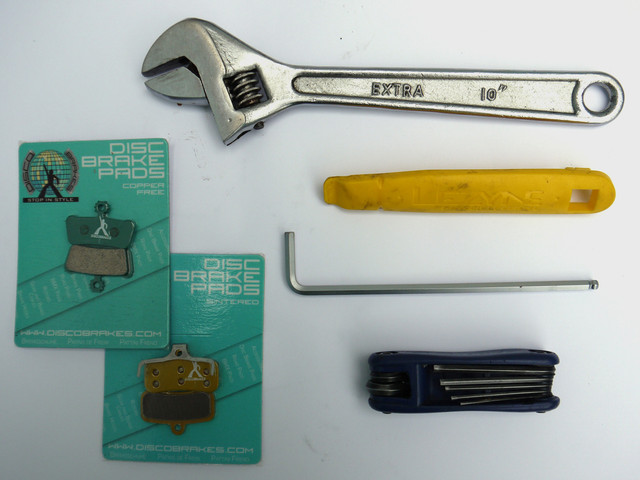

To sort out these 5 common brake issues you will need the following tools: Adjustable spanner, multi-tool, allen keys, strong plastic lever (possibly sturdy tyre lever), possibly new disc brake pads, sandpaper, cleaning products.

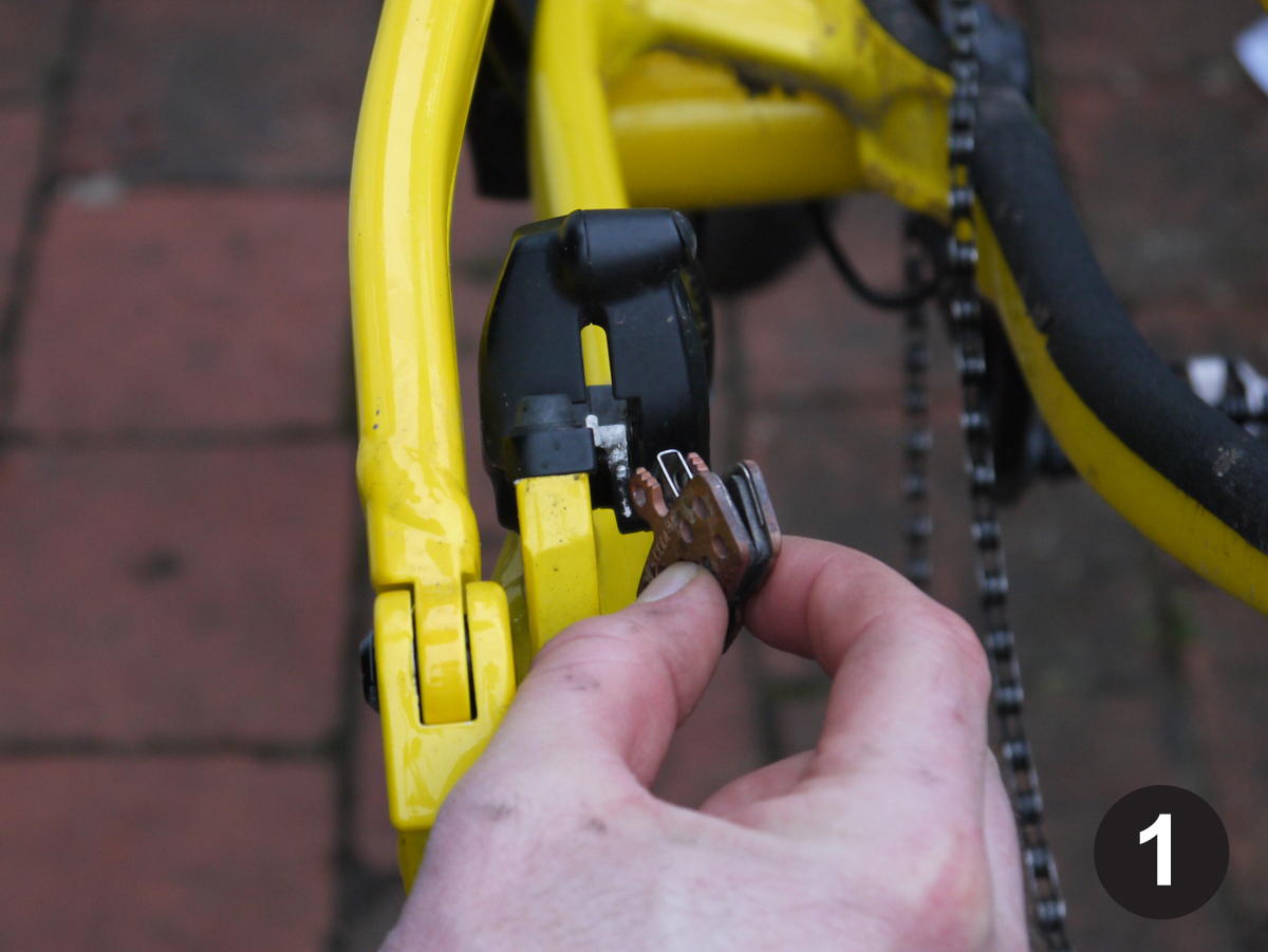

UNEVEN PISTON MOVEMENT:
1.) Remove wheel and brake pads. Put the pads somewhere clean, well away from any contaminants.

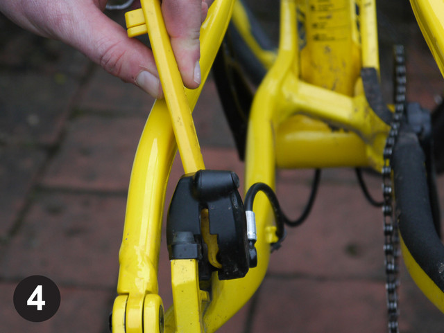

2.) Using a plastic lever hold back one piston while depressing the brake lever several times to push the other piston out. Be careful to only extend the piston a maximum of 5-8mm from its bore to ensure it does not pop out the caliper.

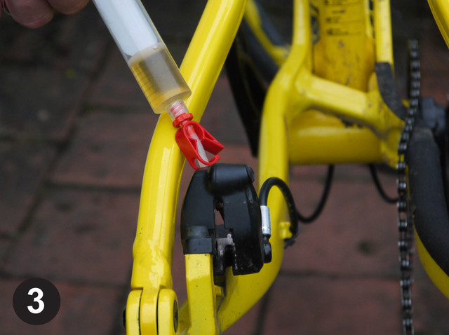

3.) Once extended from the caliper, using a syringe, carefully apply the correct oil to the outer round face of the piston. Either mineral oil or DOT oil should be used depending on your brake, so check before you apply.
4.) Push the piston back into the caliper and repeat for the other piston. Repeat this process two to three times for each side to ensure they are well lubricated.

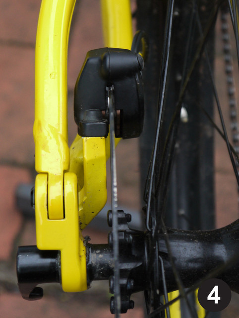

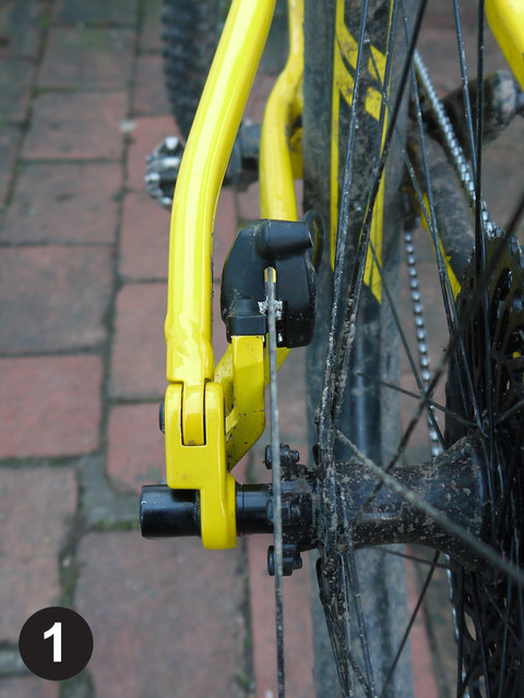

RUBBING DISC:

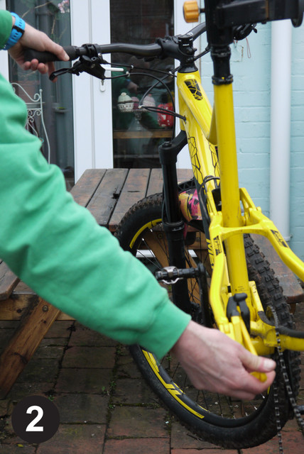

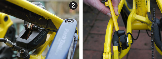

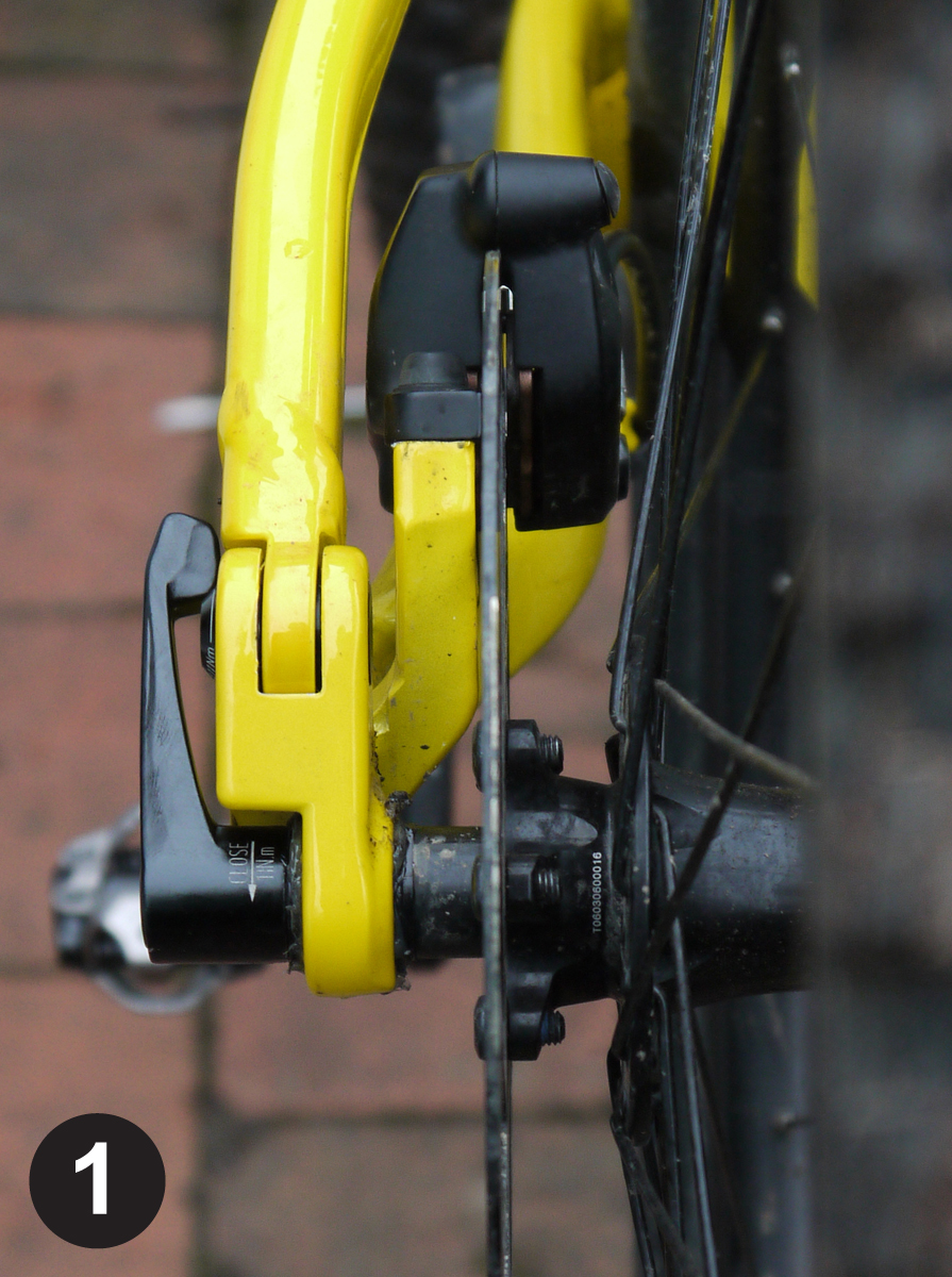

1.) Remove brake pads, but keep wheel fitted to the bike. Loosen the caliper bolts a quarter of a turn and visually centre caliper over disc. Tighten caliper bolts, ensuring the caliper is still centred.
2.) Remove wheel and reset pistons into their bores using a plastic tyre lever. Refit brake pads and retaining pin or screw, followed by the wheel.

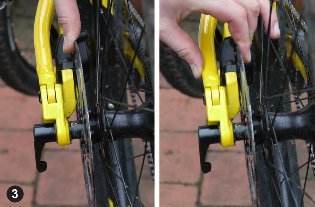

3.) Pump brake lever to extend pistons to normal working position. Spin wheel to see if disc is rubbing and assess which side of disc is rubbing. Using clean, grease-free hands, push on the disc towards the piston that is overextended. Depress brake lever at the same time to extend the opposite piston.
4.) Repeat the process until both pistons/pads move evenly.

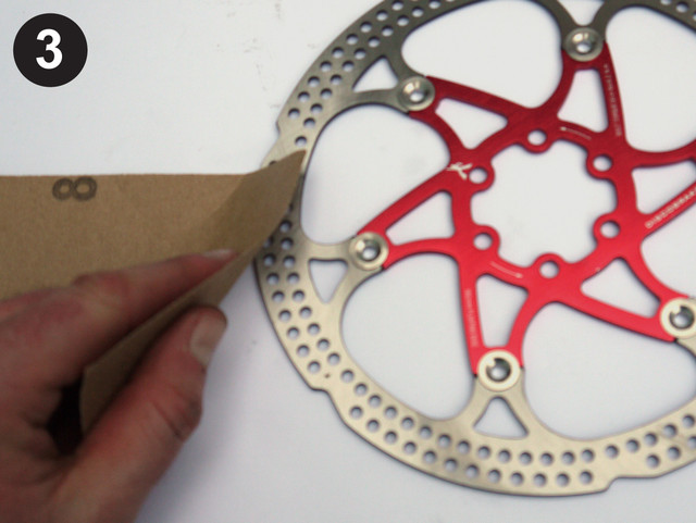

PAD CONTAMINATION:

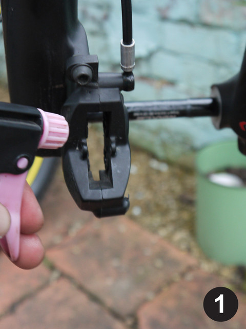

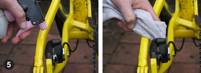

1.) Remove brake pads and clean caliper with brake cleaner or isopropyl alcohol and cloth.
2.) Replace the brake pads (shop here): this is the best option, as you will never get full performance back from the pads if they have been contaminated with oil.

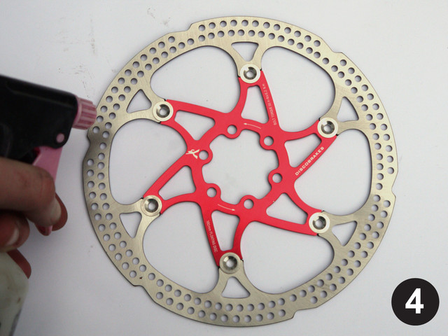

3.) Using sandpaper, abrade disc to remove contaminant and restore braking surface to an unused state.
4.) Clean disc with brake cleaner or isopropyl alcohol and cloth. Refit wheel/disc to bike along with new brake pads and bed in.

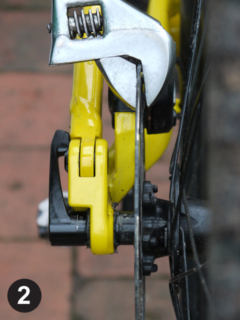

1.) Spin wheel to hear disc rubbing and locate the section of disc that is out of true.
2.) Using a very clean adjustable spanner or rotor truing tool, gently bend disc either way using trial and error until it is running straight. Start carefully as you don�t want to make it worse. Constantly reference the pad/disc gap to be sure you aren�t over or under truing.
