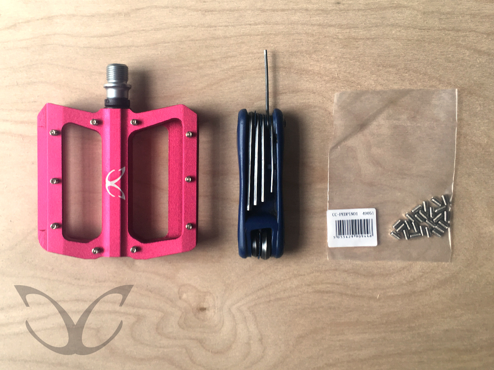

Most of the time you might only need to replace one or maybe a hand full of pins (due to wear, impact or loss of) and to do that we offer a simple and super affordable pin kit (CC-PEDPIN01 - order here) that gives you 22 pins – enough to do a whole pedal and a bit more.

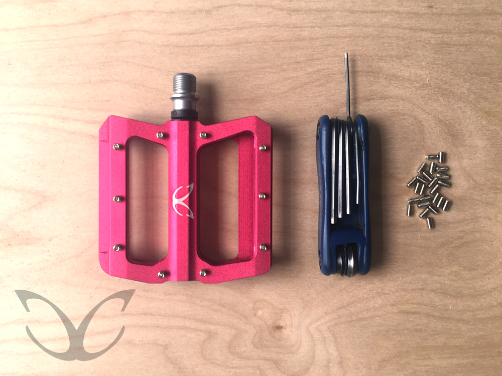

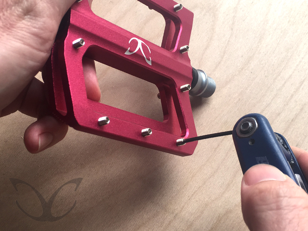

1.) What you need for the job; Allen key set (with a 2mm Allen key), your pedal and our replacement pedal pin kit.
2.) Take the pins out of the pack and get your Allen key ready.

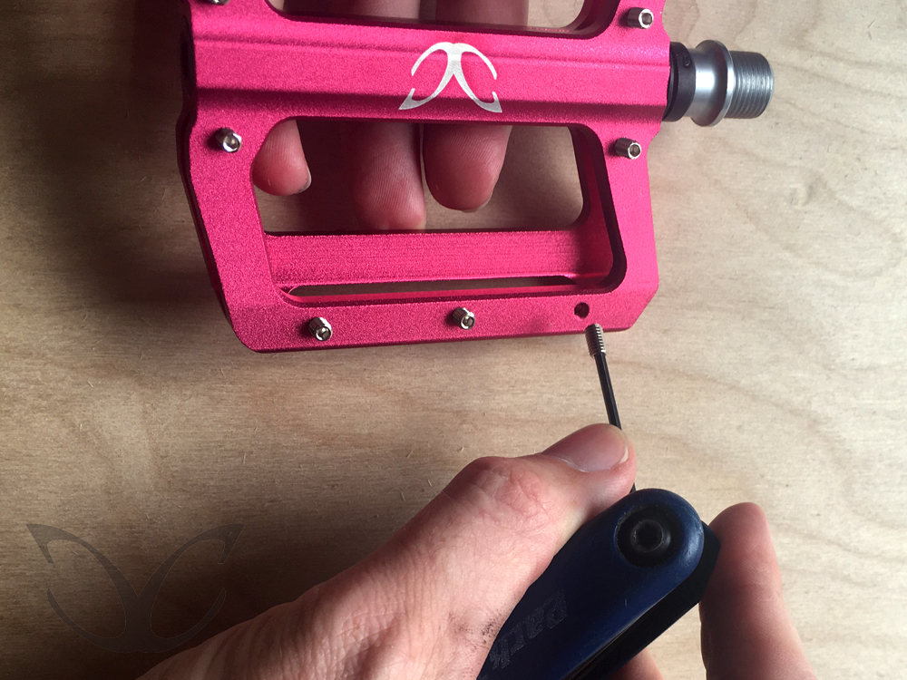

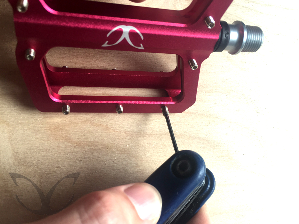

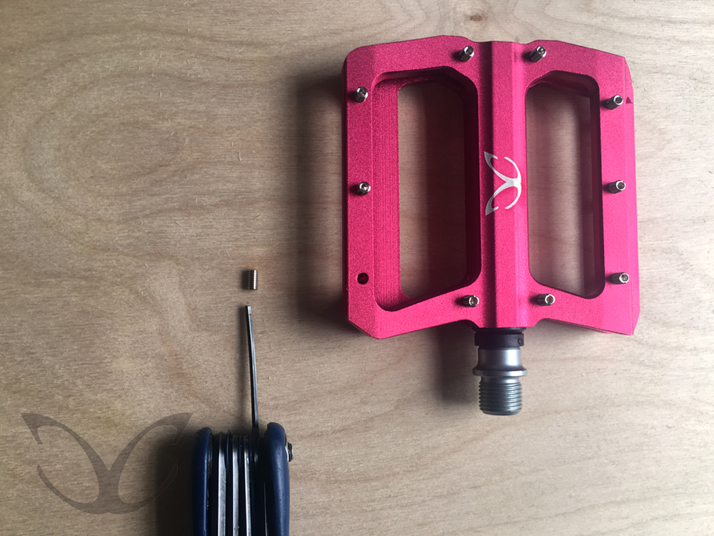

3.) Insert the 2mm Allen key into the pin and turn it anti-clockwise till the pin has come out of the pedal body. If the Allen key hole is blocked or damaged, simply use a set of pliers to unscrew the pin.

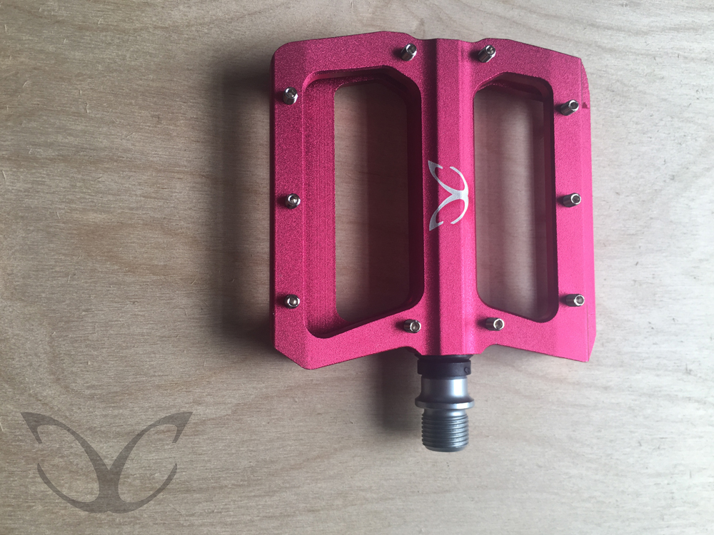

4.) Get your new pin ready. Make sure that the pedal is undamaged where you intend to fit the new pin and that the area is clean and the hole is not filled with dirt or grit.
5.) Take your 2mm Allen key, ‘load it’ with your new pin, and screw the new pin into the hole in a clockwise direction until it is tight. Please make you don’t over tighten the pin as it might damage the pedal and/or the pin.
6.) You can use a low to medium strength Loctite to prevent the pins from coming loose over time.
7.) All done, ready to hit the trails.
