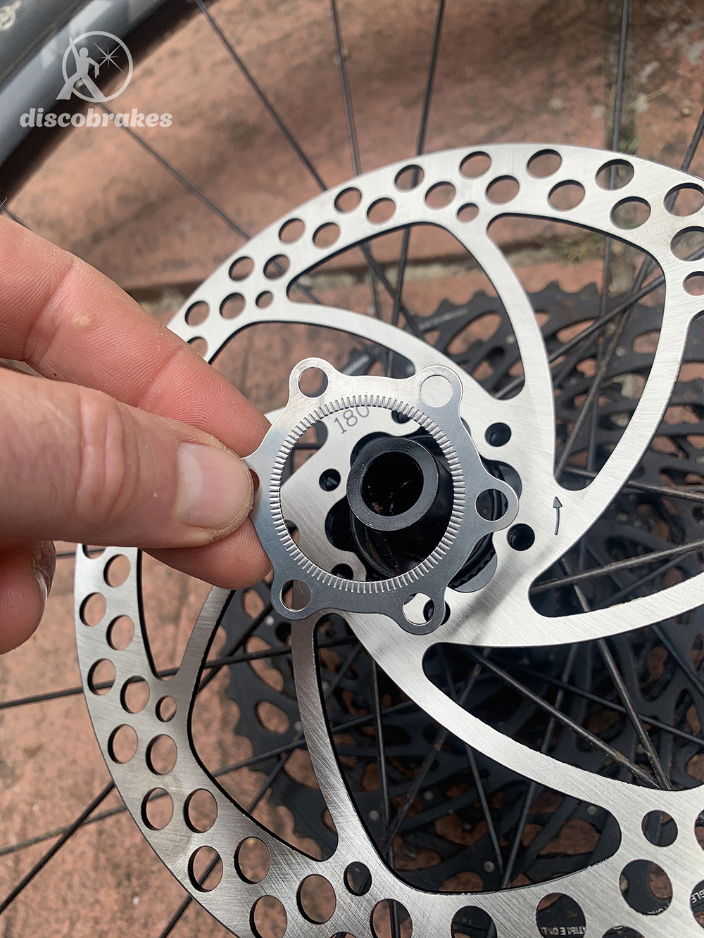

2.) Take your disc rotor and lay it onto the adapter. Make sure that it is facing the right rotational direction (see directional arrow).
3.) Put the Centerlock adapter washer (silver) onto the disc as it will prevent the adapter from rattling loose over time.

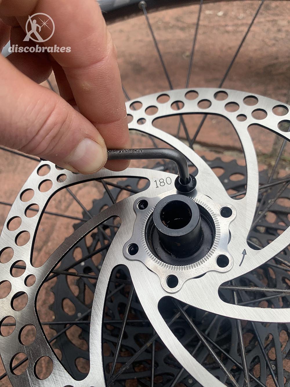

4.) Take the 1st disc bolt and screw it with your Allen/Torx key 1-2 turns into the Centerlock adapter so that the thread of the bolt has a solid grip.

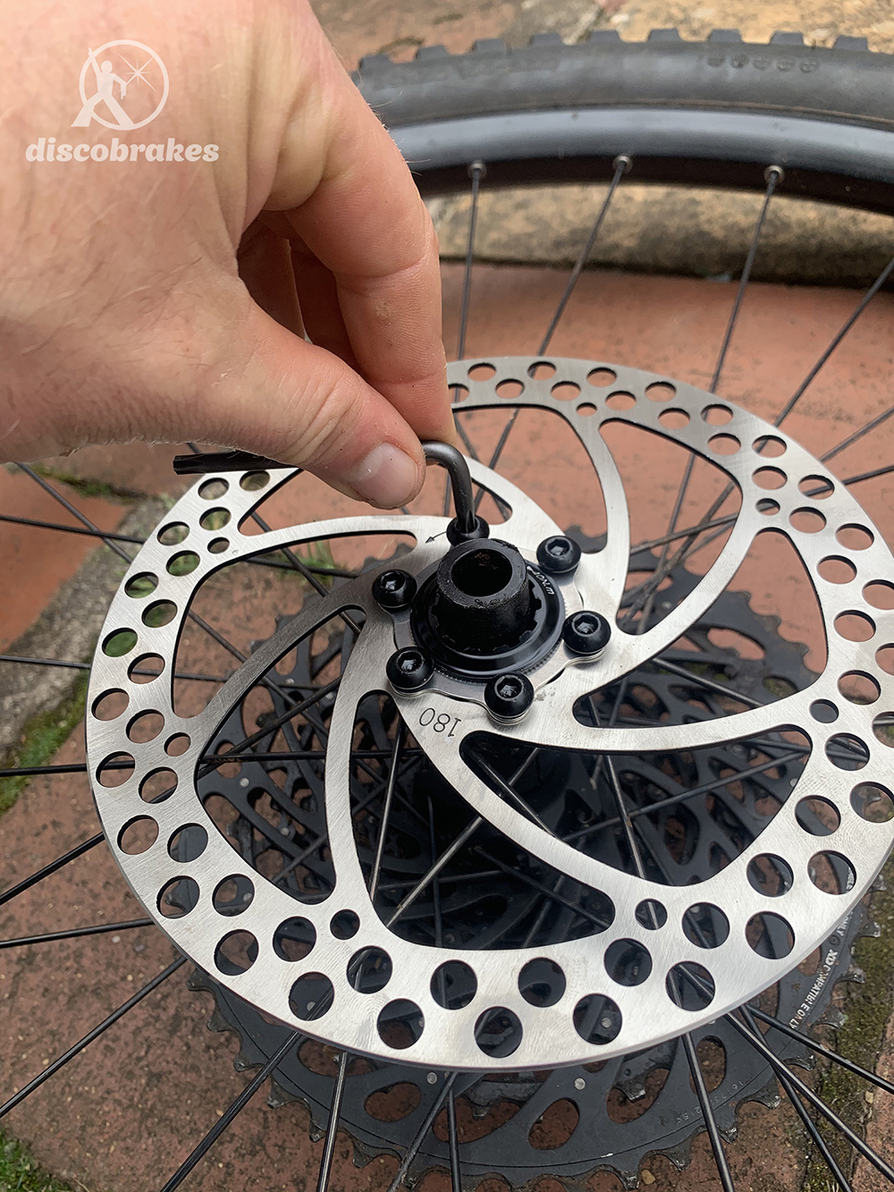

5.) Repeat the process for all 6 bolts. Please do not tighten the bolts down, just make sure that their thread has a solid grip in the adapter.

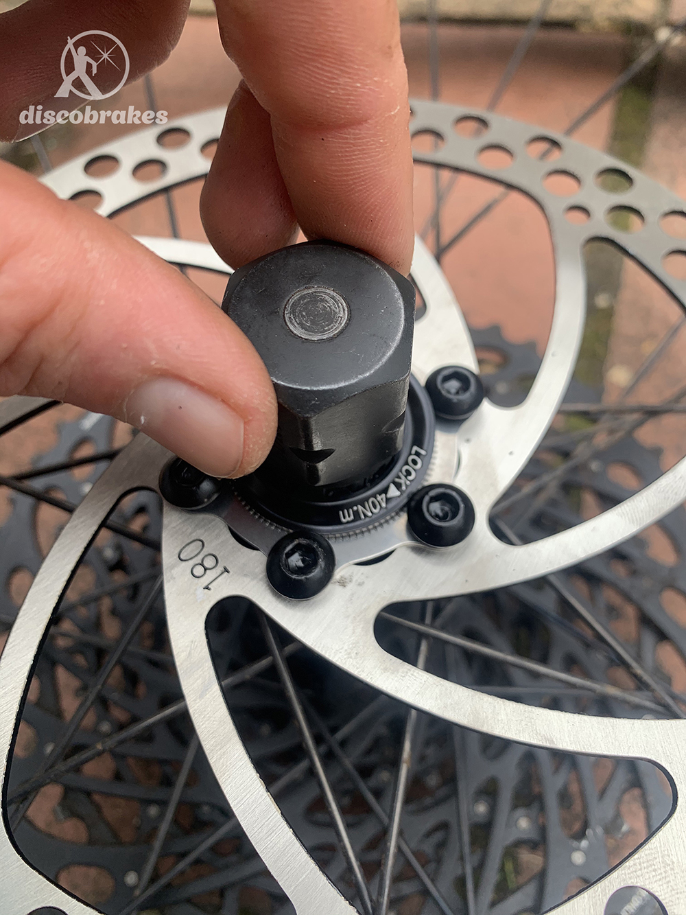

6.) Take the cassette lockring and put them over the axle into the center of the disc rotor.
7.) Use your cassette removal tool and tighten the lockring clockwise, first by hand and then with your adjustable spanner. Make sure it is tight, but equally don't overtighten it.

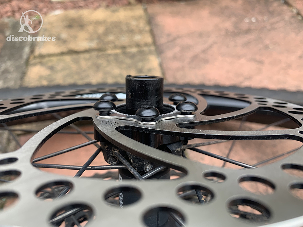

8.) To finish the installation, use your Allen/Torx key to tighten down all 6 bolts. Depending on the diameter of the rotor bolt heads, you might experience some resistance due to the tight tolerances with the cassette lockring. Use a criss cross tightening sequence to tighten each bolt a little at a time. Carefully carry on tightening the bolts down till they are flush against the Centerlock adapter washer and tight.
